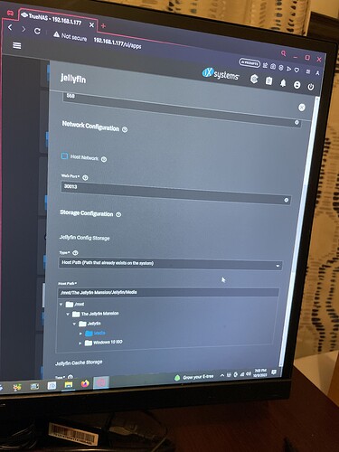

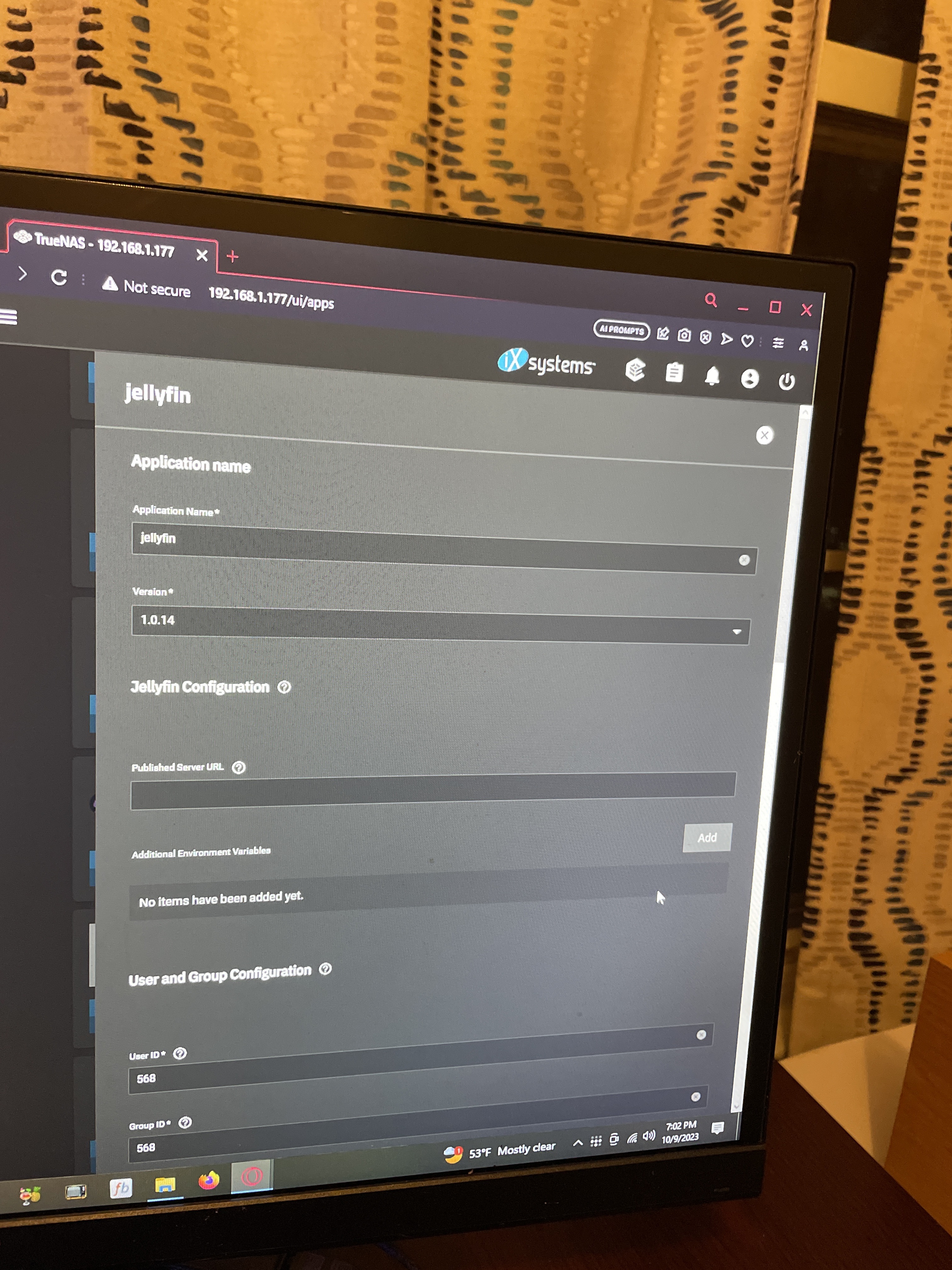

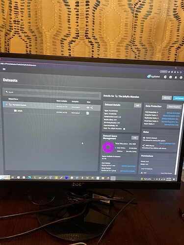

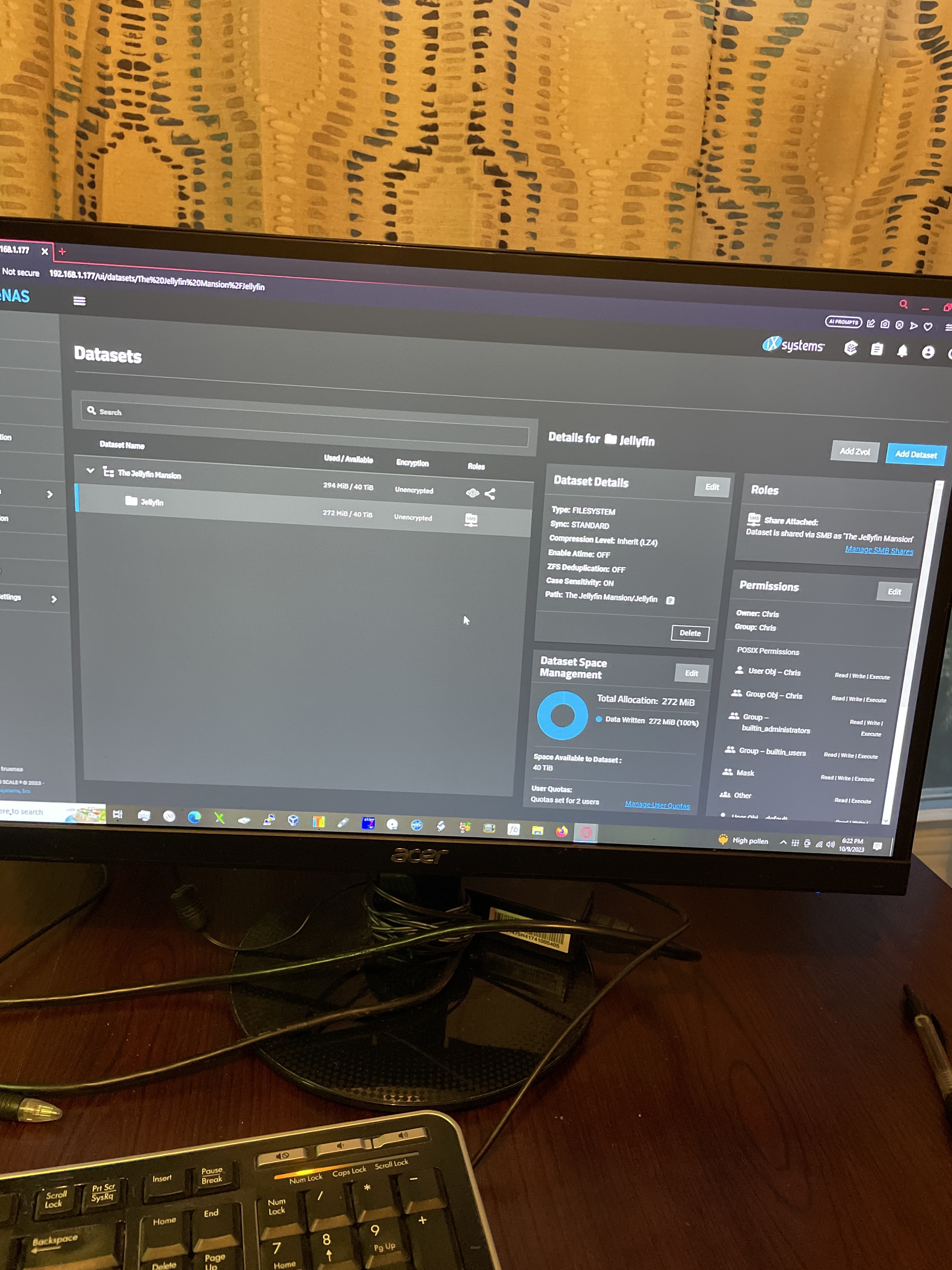

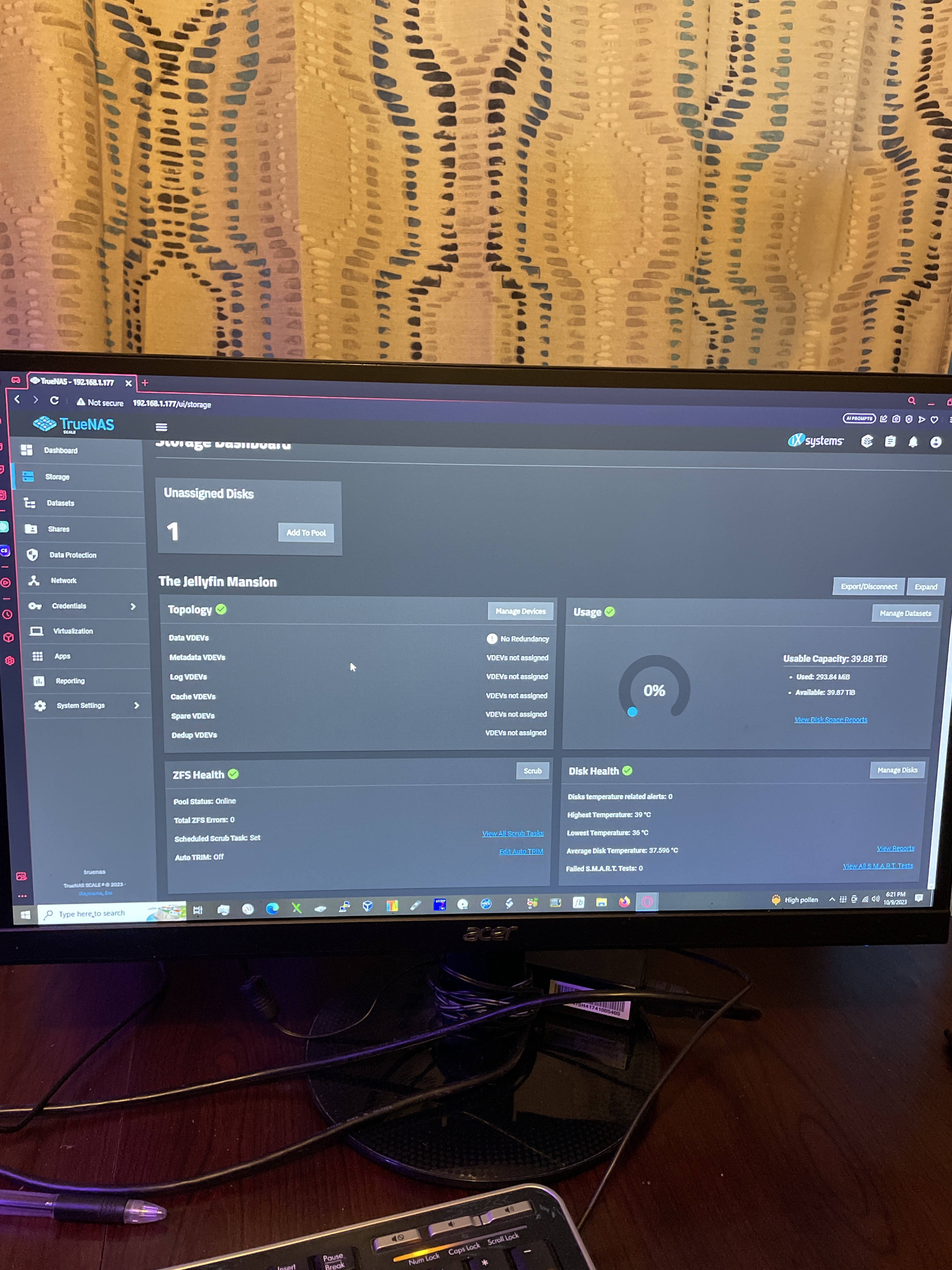

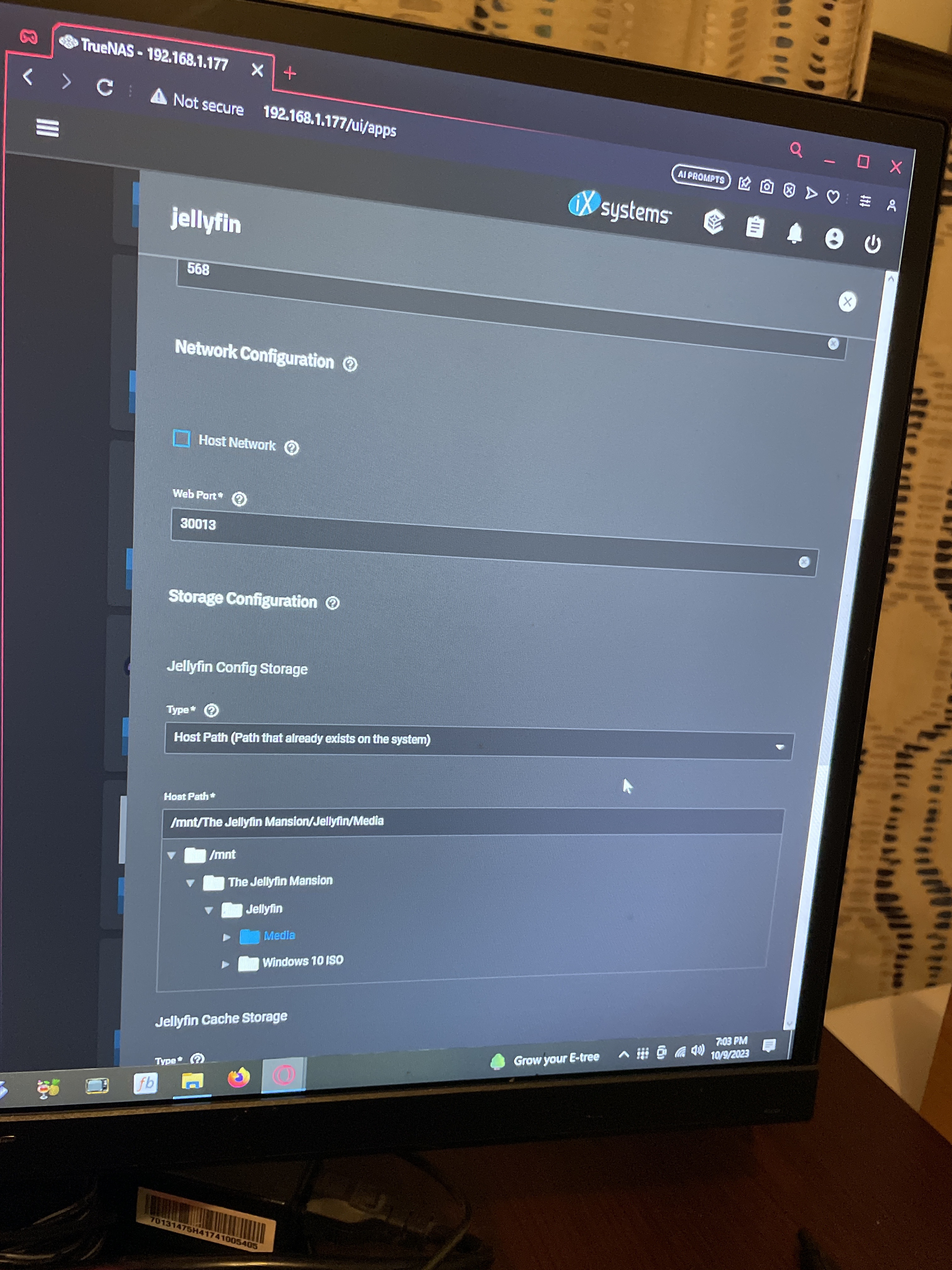

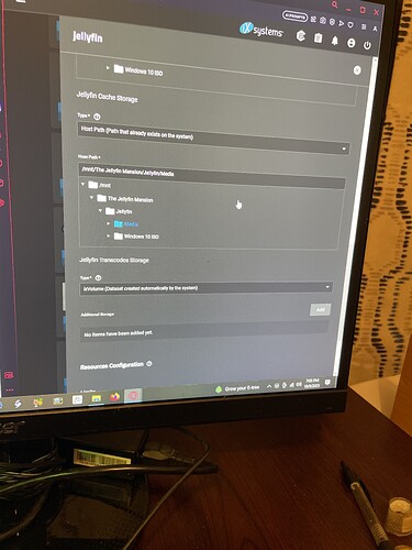

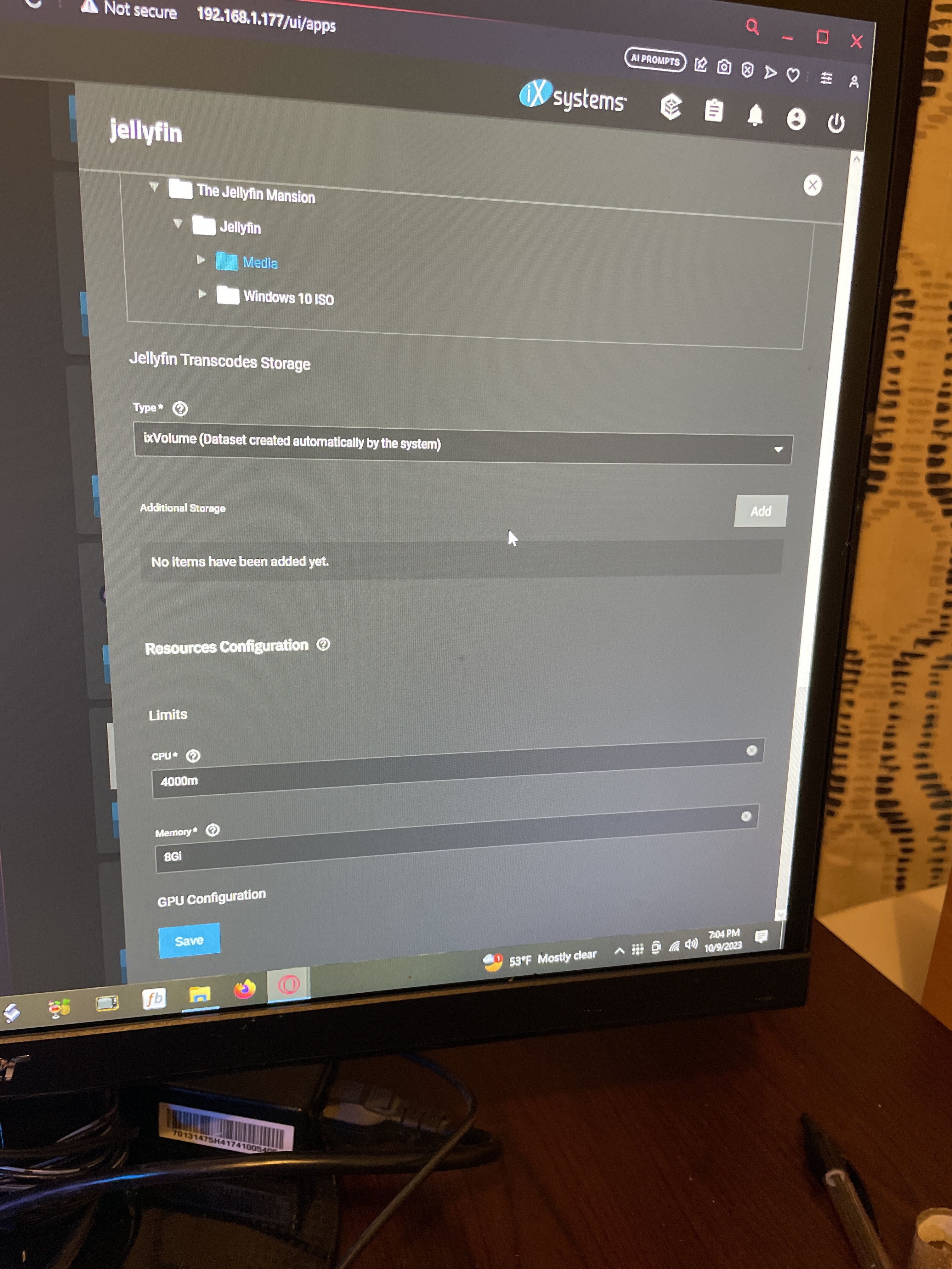

I will be taking some pictures of what I have setup for my pool and jellyfin settings when I get home from work tonight
To see if you guys can walk me through it
Do I have everything setup right or do I need to edit or reinstall jellyfin
Did you follow all of these steps?
That thread/forum be a good place to ask around. Pay special attention to the ACL instructions, or else the jellyfin service account won’t have access to the share. Best of luck.

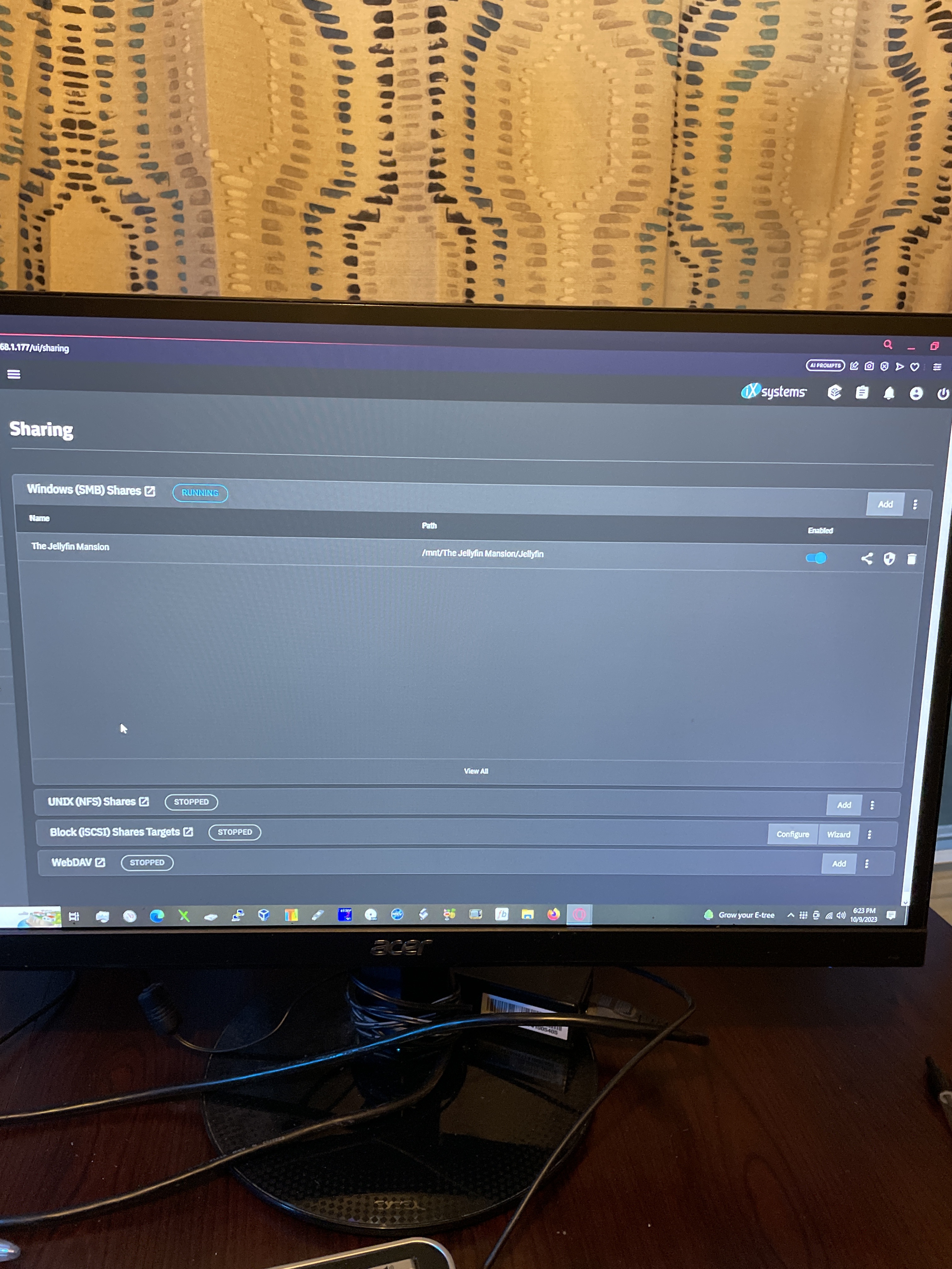

How are you getting media onto the server? Do you have an SMB share set up to your media folder?
I use Plex rather than JellyFin, but it’s a similar setup - you need to be able to get media to it over the network.
Yes I setup SMB
I can share files back and forth no issues
