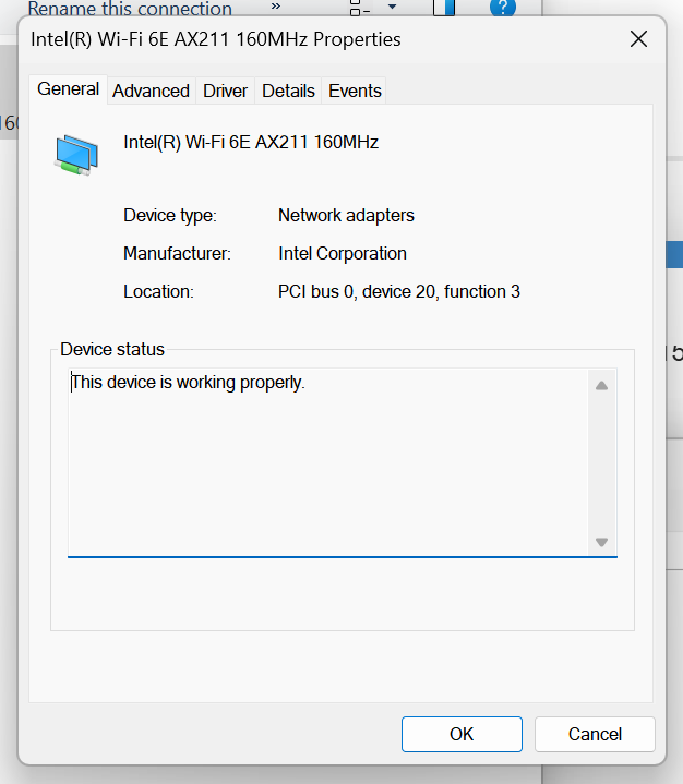

Why is my Windows 11 WiFi speed slow?
Something I’ve noticed since we’ve had fibre Internet rolled out here. We now have 150 Mbps up and down. 802.11ac Deco mesh.
Every device gets 150/150 when we do a speed test except my Windows 11 laptop. The laptop maxes out at around 80 Mbps.
Recent laptop, Intel WiFi 6e, connects as expected on the 5GHz network.
When I connect to the mesh unit in the room using a network cable, I immediately get the expected 150/150.
Any settings I should be looking at on the WiFi config?

I think I found the issue late last night though. It’s the layout of the house. Where the laptop usually sits on a desk, there are large bits of oak in between it and the nearest AP. If I move it so it has a clear line of sight, I get the expected speeds.

I’ve just tested putting a second AP in same room behind me - fixes the issue. So all I need is one more AP. Or sit somewhere else working on the laptop!
