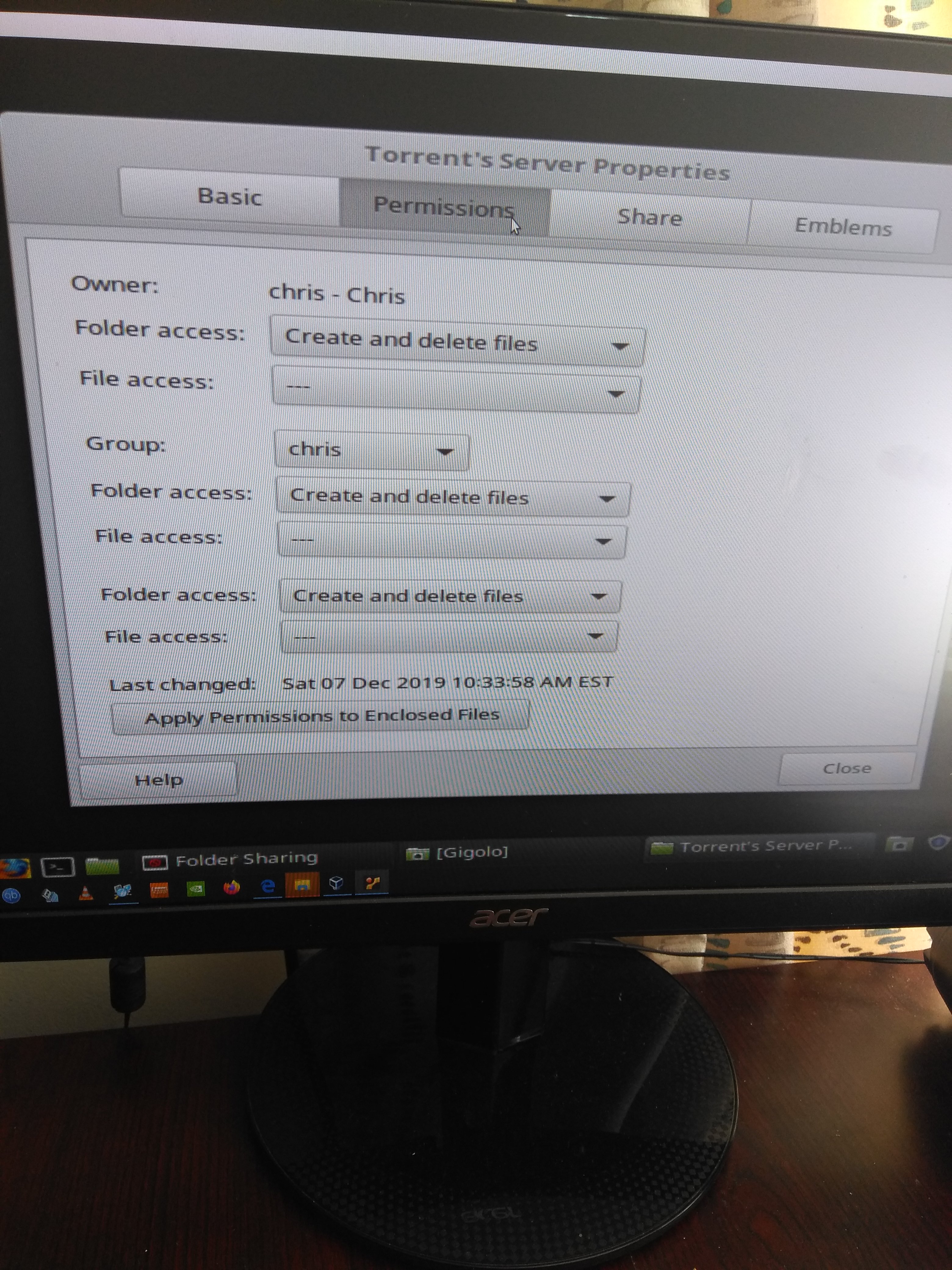

I’m trying to setup the wizard for Linux mint filesharing to setup this folder called Torrent’s Server
Here are some pictures of the setup
Here’s is what it is saying on windows 10 when I try to log in
When ever I try to input my username and password
Not letting me log in to Linux mint share folder
I’m a newbie to Linux mint
Any help would be greatly appreciated
So at the last picture is were you get the wrong user name or password error?
The Samba service uses it own users and passwords, so you have to make one with the smbpasswd command:
smbpasswd -a chris
-a will add a user, -x remove.
