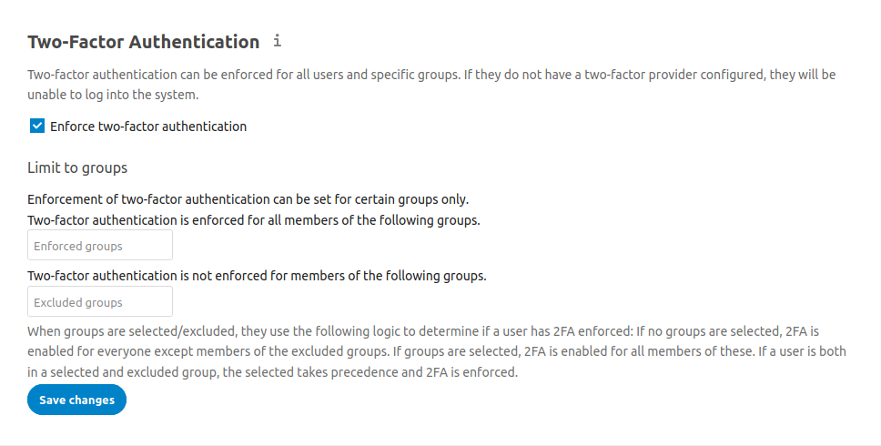

That’s an excellent thought I shall investigate. Thank you for this! I might even look out for a Yubikey plugin to NextCloud and use that thing. Thanks!

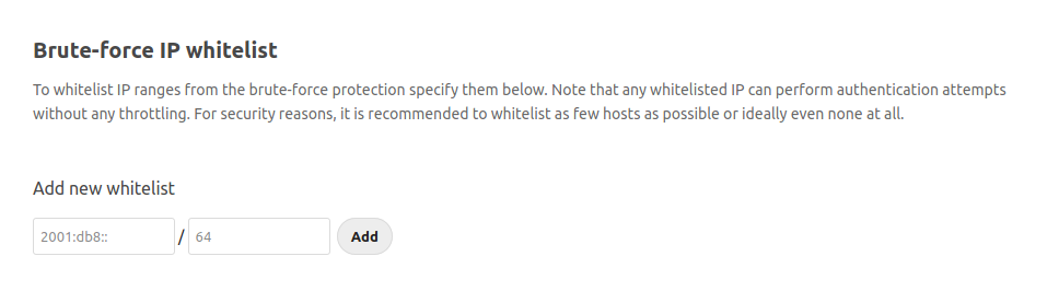

Nextcloud also has a brute force protection built in. And 2FA options, if required. Under Settings —> Security.
