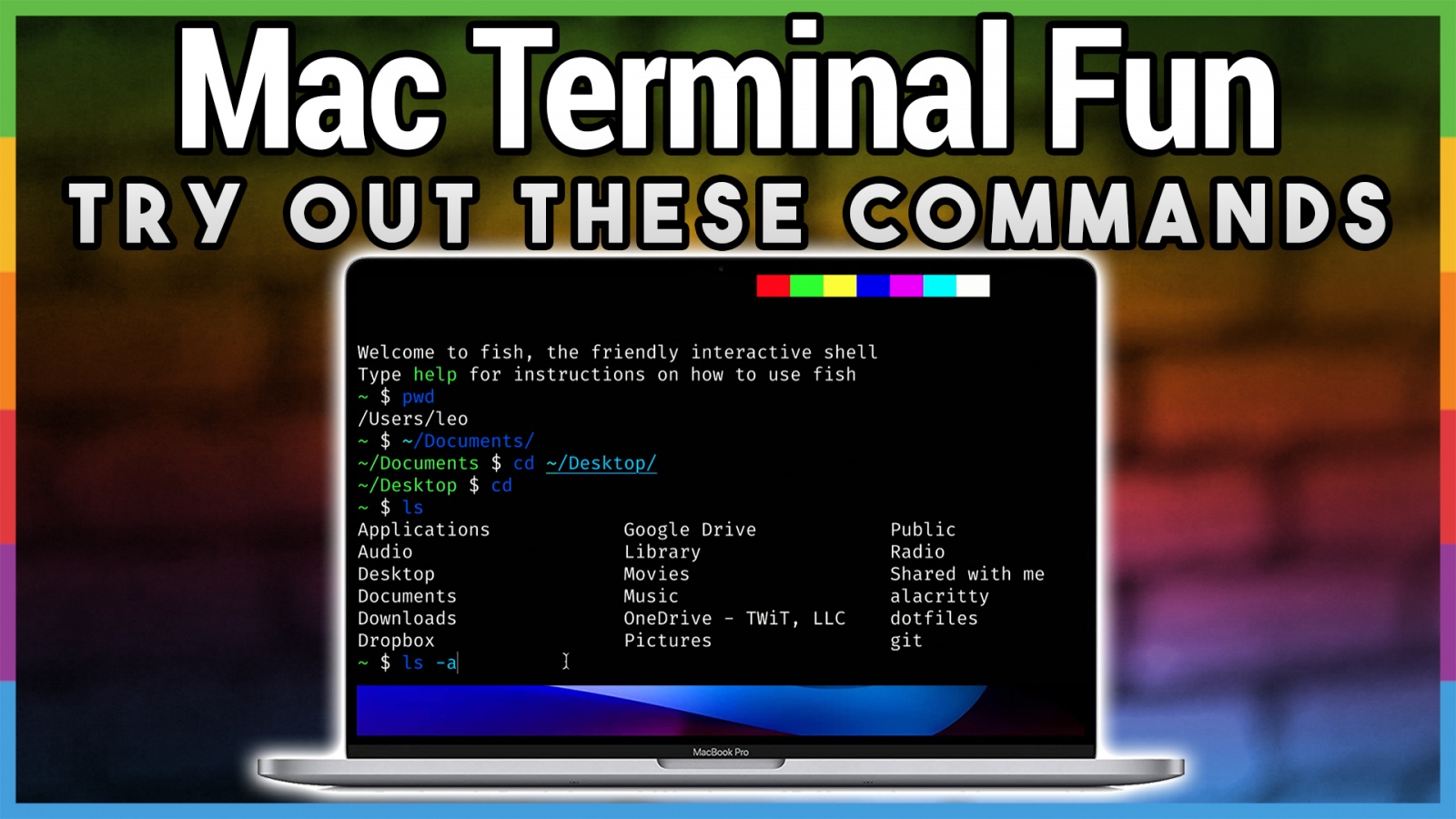

@Leo love this new show, just wished they were longer. Also how can I get my terminal to load fish skin when I launch iterm2 without having to type the comman?
Fish is one of many terminal shells you can use with your Mac. For years macOS came with the bash shell. With Catalina, Apple changed it to zsh, which many prefer to bash (including me). Most Linux distros default to bash, as well. Once you find a shell you like, change it everywhere or you’ll get confused!
You can install fish using brew: brew install fish
Typing cat /etc/shells will show you which shells are installed on your mac, including their location.
The command to change shells is chsh so you can type this bash command:
chsh -s $(which fish)
to make fish your default shell (once you’ve installed it). The next time you launch your terminal you should see the fish greeting.
fish is more modern, but does some things differently than bash so read the documentation here: https://fishshell.com/ and don’t forget to customize your prompt and theme with the fish_config command.
Enjoy!
