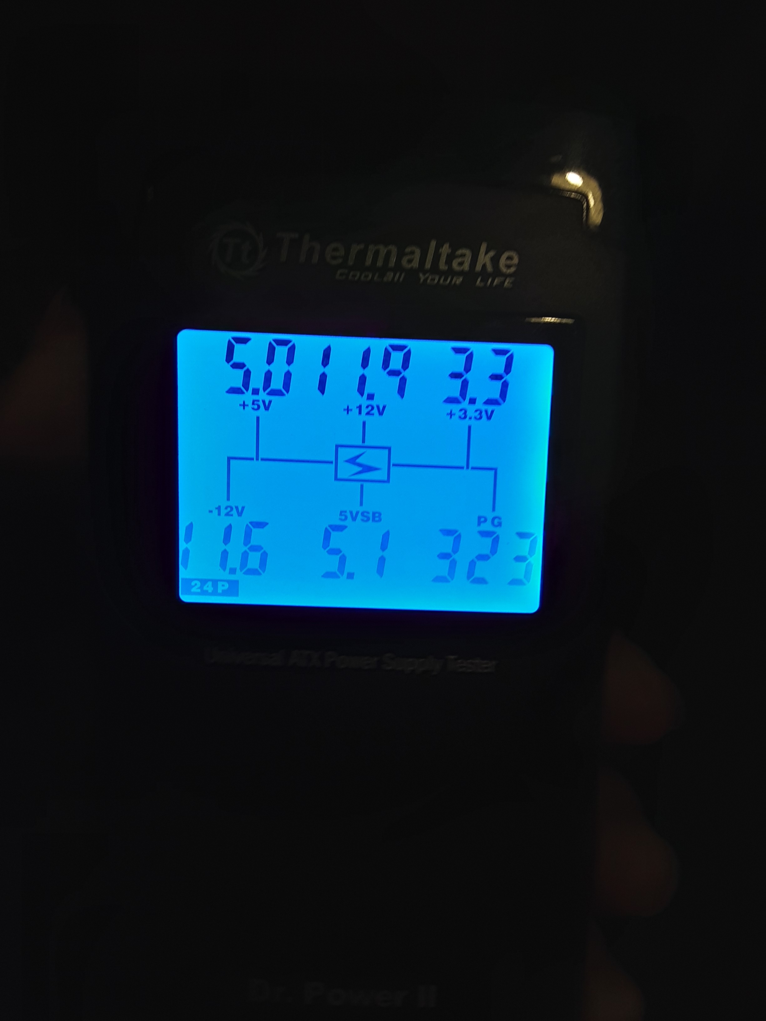

One of these might be helpful
@PHolder Here’s the reading I got:

Well you know the PSU is good, so then there are really only a few things you could have wrong…
