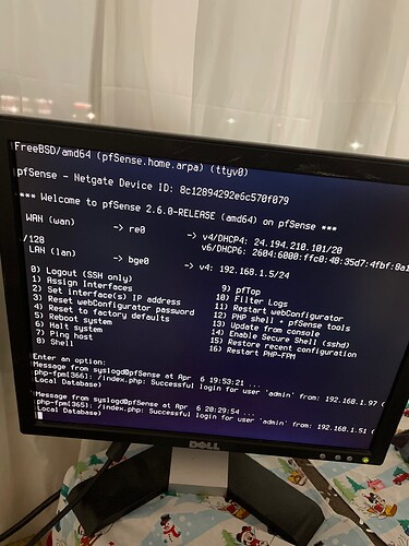

Start by asking one of your devices (PC) to show whether it is getting an IP address or not. If Windows, bring up a cmd shell and type ipconfig/all . If the device has an IP address not in your LAN range (169.254. 0.0 to 169.254. 255.255), it’s probably and autoconfig address. If it has an expected IP address, then your firewall rules are probably blocking you. If you don’t get an IP address, you have an issue with DHCP.

To start with, I would try putting pfSense as your primary router, and put your wireless router into AP mode (also known as bridge mode) and plug it into the pfSense. This will turn off a lot of your router’s features, but it will let you experience pfSense as your primary router. You may have to play with firewall rules at this point to get traffic flowing as you like. Once you know how to do all this, you will have figured out pfSense pretty well, and now you can decide if you like the result, or you want to switch to something else.
If pfSense has 192.168.1.1, then the Router also needs a 192.168.1.0/24 address, otherwise they won’t see each other.
If the pfSense is plugged into a LAN port on the router, the other devices on the network will also need an address in the 192.168.1.0/24 range (I’m assuming you aren’t using any VLANs). The router needs to have the pfSense as the default gateway.
If the pfSense is plugged into the WAN port, the WAN port on the router will also need a 192.168.1.0/24 address, but you can then use a 192.168.2.0/24 address on the internal network and the router remains the default gateway and all devices on the internal network also get a 192.168.2.0/24 address.
Personally, I’d plug the pfSense into a LAN port on the router and put everything in the same address range and finished. Especially if you want to use openVPN/Wireguard on the pfSense.
You can only have one DHCP server active. You will need to decide, whether you want the pfSense or the router to be your DHCP server.
From your previous message:
pfSense 192.168.1.1 connected to one of the internal network ports on the router
router 192.168.1.2 set its Standard Gateway setting to 192.168.1.1 (pfSense)
In router, disable DHCP.
In pfSense, set DHCP to offer:
Lease addresses in range 192.168.1.20 - 192.1681.254 (I always leave some addresses free at the front for critical devices that get a fixed address)
DNS - 192.168.1.1
Standard Gateway 192.168.1.1
