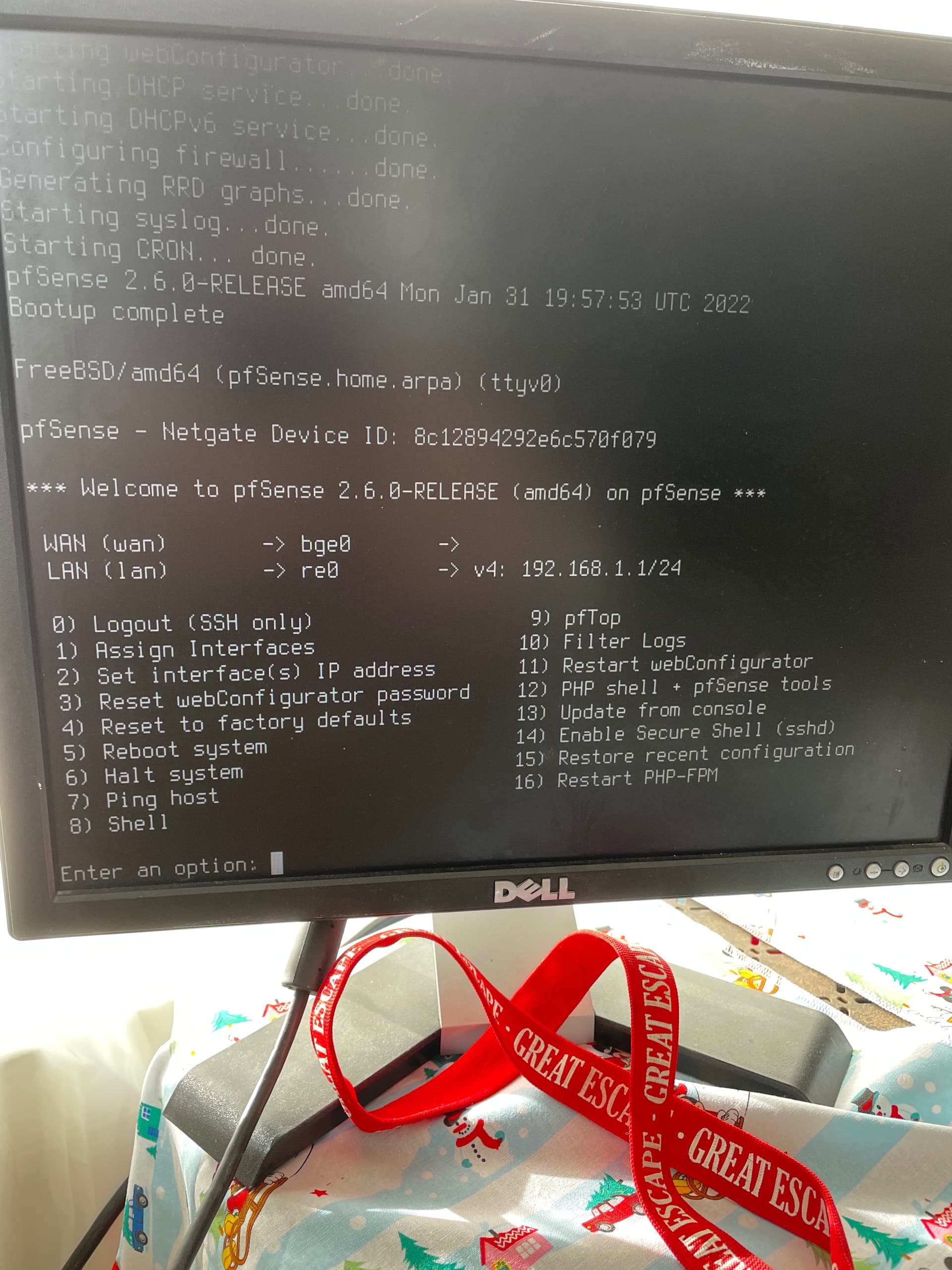

I’m not getting any wan IP address
But I can get to the webpage to setup PfSense

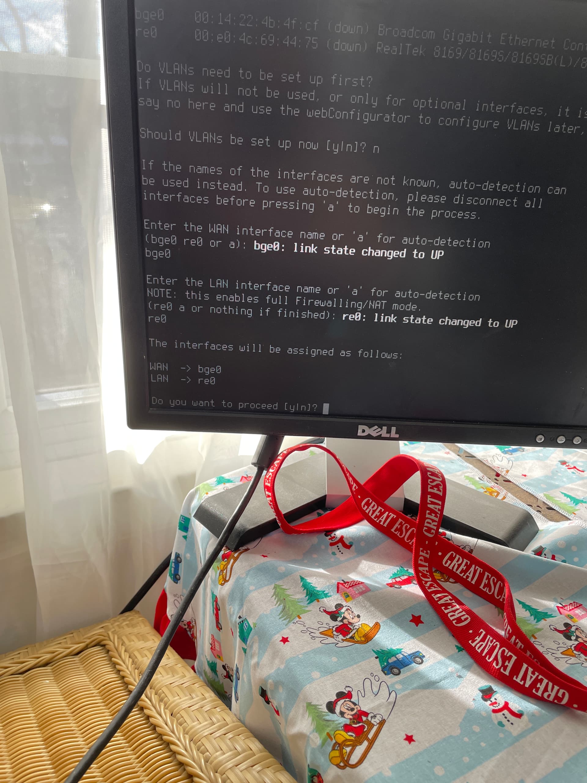

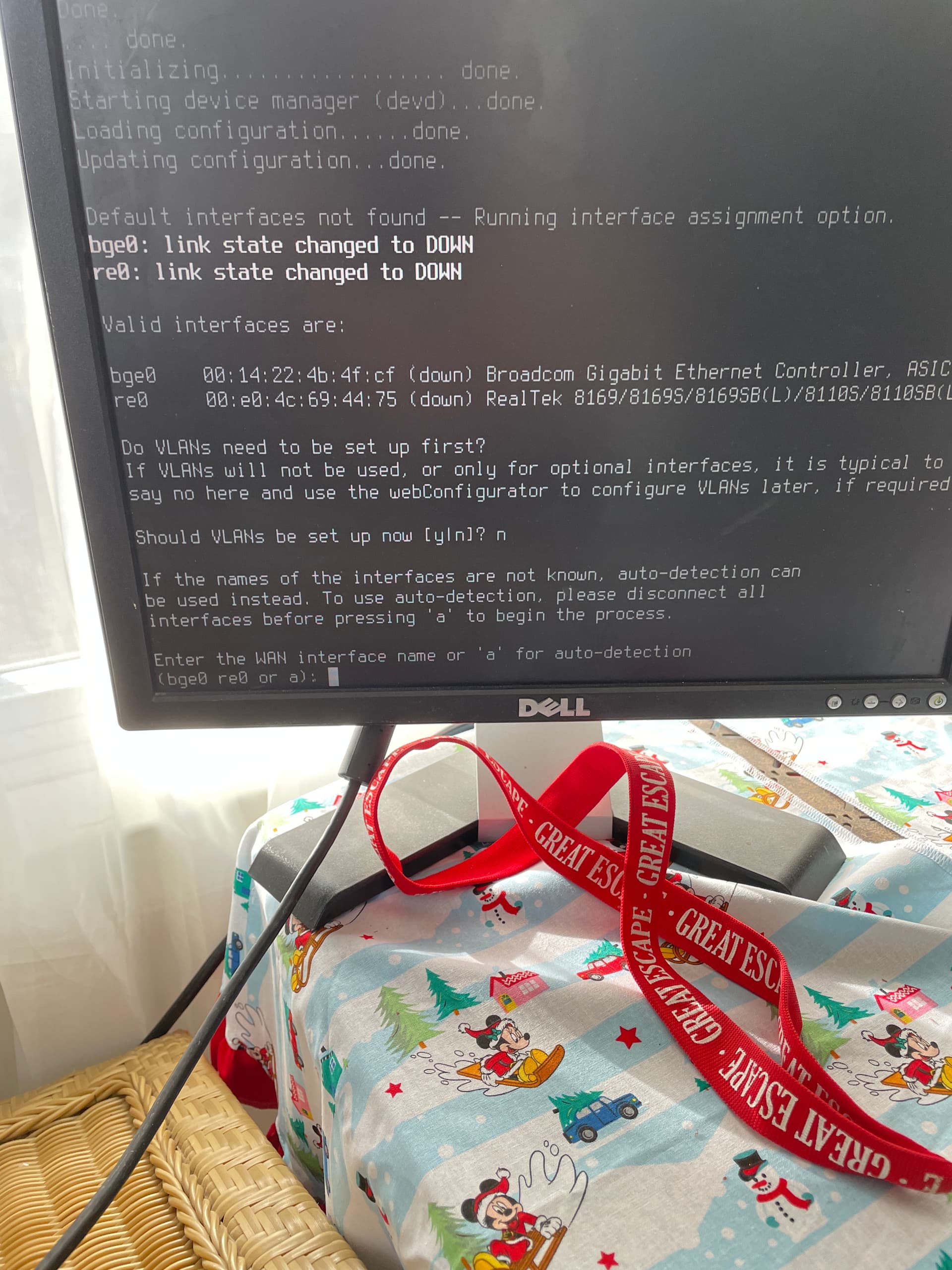

What device are you using to run pfSense? If it’s just a PC or similar, does it have TWO network ports (NICs)?

To be clear, a firewall device MUST have two NICs. If you’ve not been using two, one for WAN and one for LAN that would explain why nothing is working for you.
The original screen shot show public v4 and v6 IPs on the WAN interface so looks ok for interfaces at one point.

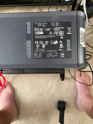

I will take some photos of dell computer that I’m using and photos of all the setup webpage photos to have you see what I’m seeing for PfSense setup

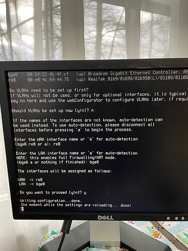

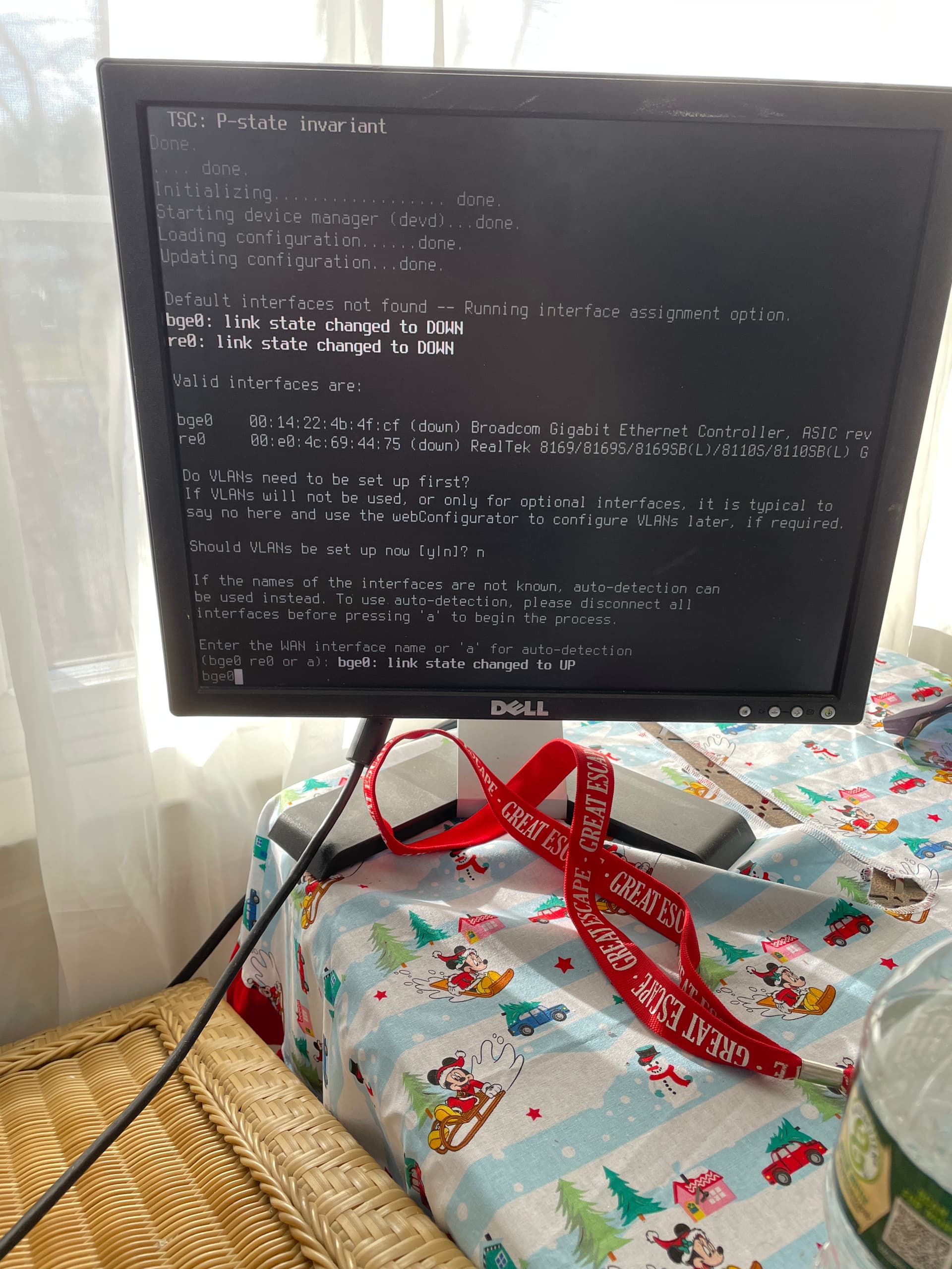

Also re0 was your WAN interface in your first screen shot where you got an IP from your ISP but you’ve set it as a LAN interface this time.

Not necessarily, I would try and get it working with a wired device without the linksys first. If your linksys is the only ethernet switch you have then you will need to do this, but I would connect a switch to your pfsense LAN port and try getting a wired connection to work without the linksys in place.

I just tried to reinstall PfSense
But no wan ip
How do I reset the Ethernet card to factory settings
