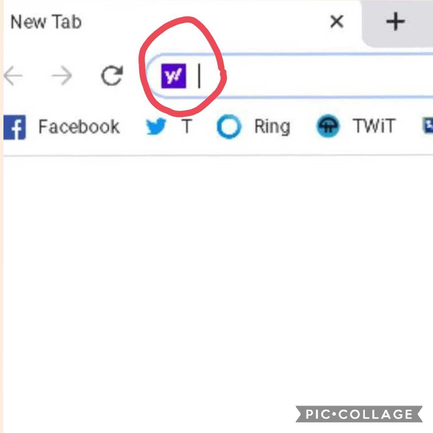

What is This, just appeared!
Your default search engine is set to Yahoo maybe?
Nope! Haven’t visited Yahoo in 17 years
Well that looks like the Yahoo logo. Is that in Chrome?
i agree with @Pommster, guessing some site or software hijacked your default search provider.
I doubt that could happen on a Chromebook. You can bet I’m not typing anything in that box until I learn more on whats going on. Where is Leo when you need him
Go to settings and advanced and make sure you have Google set up as your default search engine. If in doubt power wash your Chromebook.
The following thread on the Chromebook support site should help.
https://support.google.com/chromebook/thread/591017
Try this URL:
chrome://settings/searchEngines
Whether you visited Yahoo or not, what is your current default search engine ?
Try resetting it.
May help to have a second opinion of the browser setup.
https://browsercheck.qualys.com
Before going to “Power Wash” I tried “Reset settings” and it worked.
Thanks for your help!

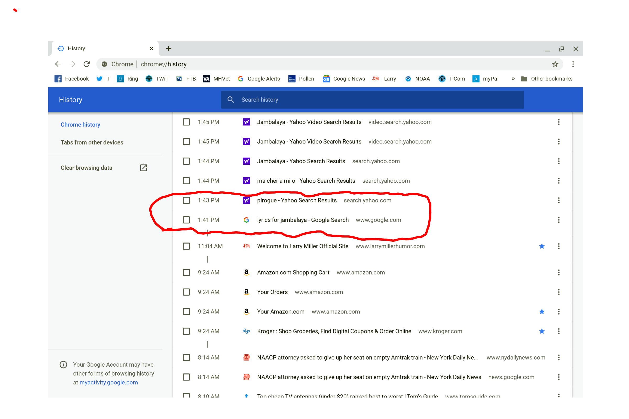

This is interesting. I went back into my history to see where Yahoo hijacked my search bar. It happened just after I visited a site for song lyrics! I guess this is how the lyric guys make their money! LIVE AND LEARN!

I was using that extension. Guess it did’t work. In this case it was probably party #2 that did the dirty work.
