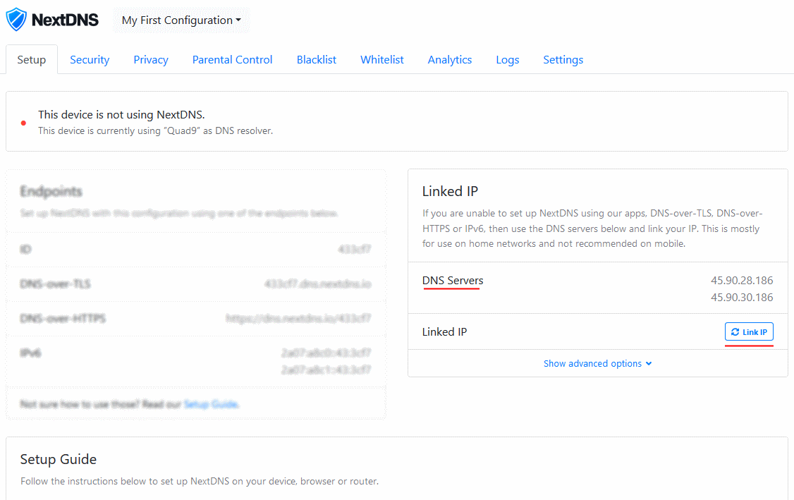

If you go to their web page, they give a setup page, with a bunch of different ways to set it up. If you want it to apply to all devices in your home [WiFi] network, then you would want to apply it at the router. Here’s the relevant portion of the setup page:
