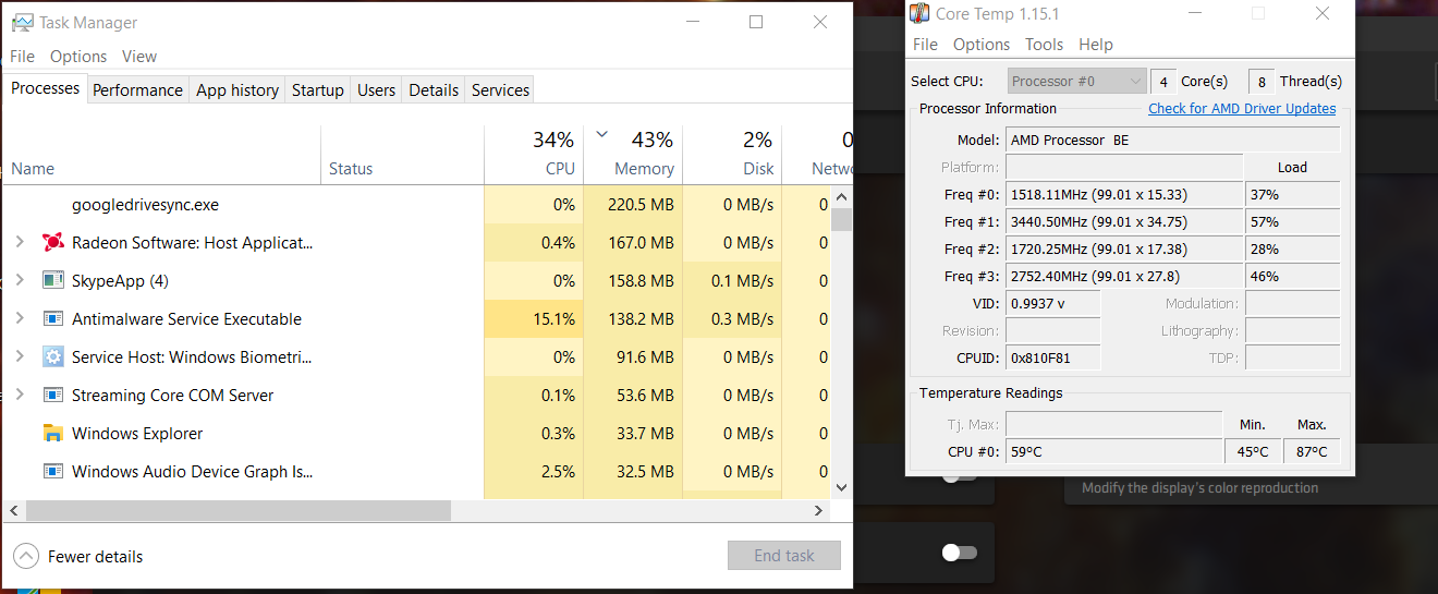

Computer restarted and brightness issue came back, flipping the switch in AMDs software fixed it again.
Here’s the photo you asked for:
What laptop model is this? Strange it cannot identify your actual CPU. 50C isn’t too hot, but the maximum of 87C is a bit on the high side, but should still be in the range of the operating range of the CPU itself. If all else fails, you could reset windows from safe mode?

Would like to see whats in the start up tab in task manager
HP Pavilion 15-cw1018ca with Ryzen 5 and Vega Mobile graphics.
