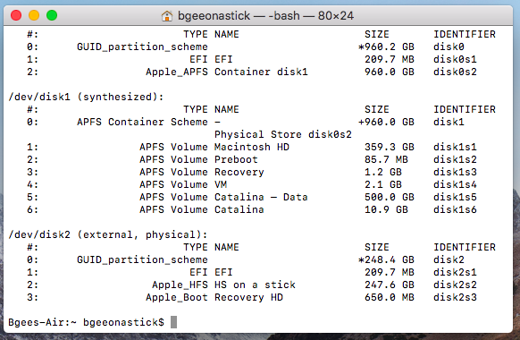

Spent hours trying to re-create your problem by installing HS on an external drive using every format possible using Disk Utility. No matter what I did, I never got the message you saw. Did learn a bit about Disk Utility.
When you format a drive for GUID, you automatically get an EFI partition on the drive you format.
Also, when I created HS on a GUID formatted drive, I get an Apple Boot Recovery drive on the external disk.
image Screen Shot 2019-10-16 at 9.56.00 am
On the attached list, with HS running on the external drive, the external drive is disk2. Disk0 is HS on my internal drive, Disk1 is Catalina on my internal drive.
Suggest you start by entering “diskutil list” on a terminal window and see what you have.
