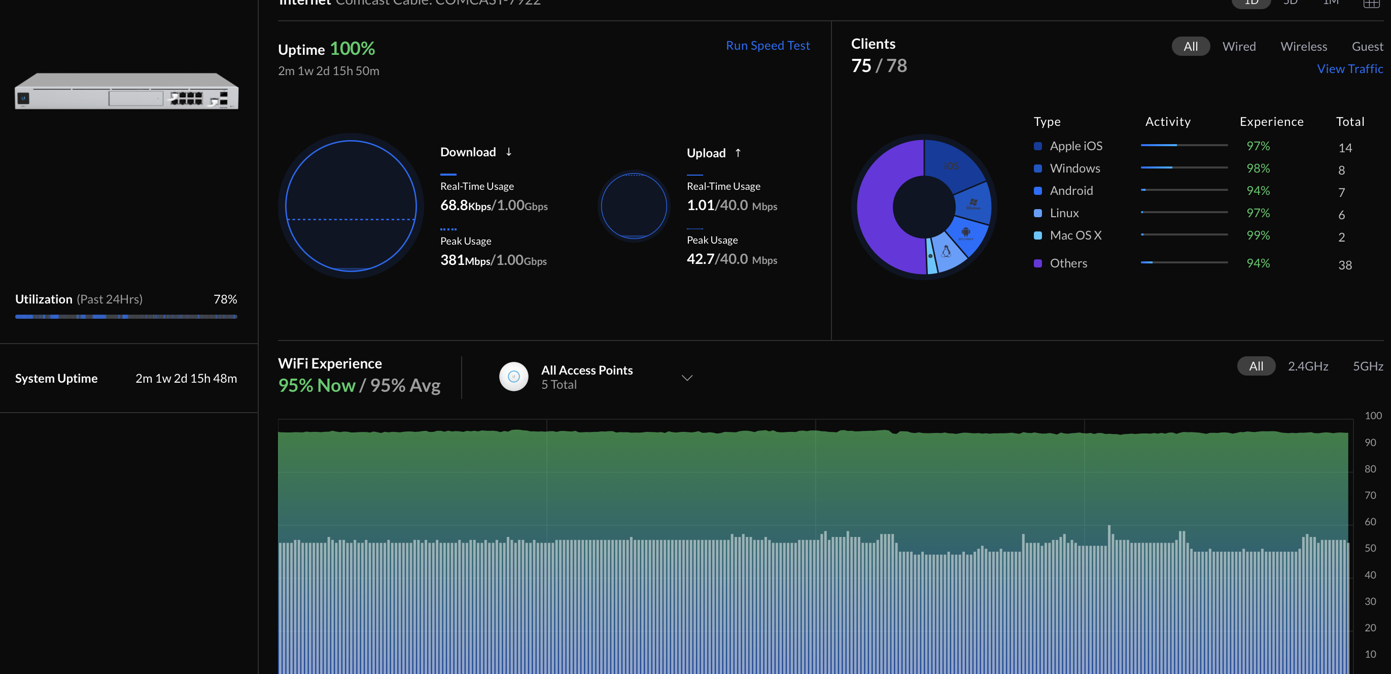

@Leo Thank you for the screen shot. Very helpful. I am going to call my CDW rep to get an evaluation unit. More context. I am sure you have dealt with this. IT says Wifi is fin and end users report intermittent problems. So I was thinking of a https://www.monitor-io.com/ type solution where I can fedex a few units out to a remote office and in a few days, get a true sense of performance. Have you come across anything in your past to point me in the right direction. (I really enjoy your podcast btw)
As I said, traffic is best monitored at the router, but you can easily measure signal with an Android phone or laptop. There are many Wi-Fi analyzer tools on Android. I use Inssider on WindowsâŚ
This wonât reveal problems with individual clients, but it will help you map the signal in your office.
