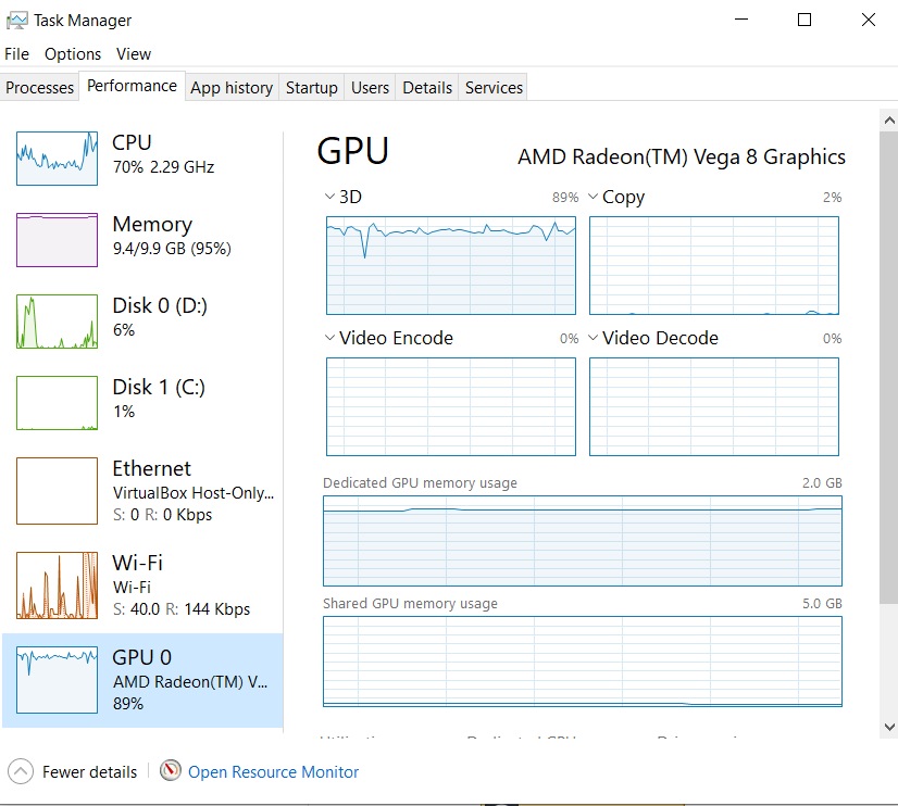

Today I started using the computer and noticed! that the fans were going crazy and opened task manager and found this. All I had open was some web browsing tabs, PowerPoint, Discord, Word, Teams, Acrobat and a couple of UWAs. None of that should be so GPU intensive, right?
Update:
I’ve restarted since I originally wrote this that seemed to help the GPU process part but the computer is still having the heat problems. Core Temp still consistently reads between 40° and 50° no matter what.
Hi @SamGreenwood, the GPU being always on with high usage when not being apparently used is probably the AMD Radeon Software instant replay recording cache. If you have “Desktop Recording” and/or “Instant Replay” set/or is default ON in the AMD software then the GPU is always streaming the display to cache/recording. Try checking/turning off this feature and then check the GPU, which should now be close to idle
