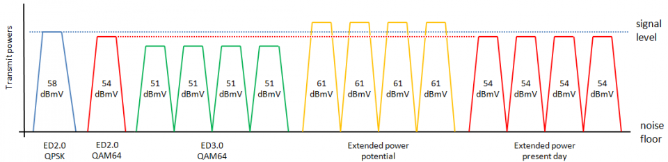

Any reason why I should turn on "Enable Extended Upstream Transmit Power "?
The cost of the multiple ports is minimal, because it’s basically one chip (a network switch on a chip) and the assembly of the 4 ports is a so common that it probably costs the same as the assembly for one port.
The potential benefit to having 4 ports is that you could pay Cox for multiple IP addresses if you wanted (business accounts certainly have this ability, I assume residential ones could do likewise.) The other simple benefit is sometimes hardware fails in weird ways (say you trip over the wire and rip it out of the modem) so you might be able to switch to another port.
I don’t know what this offers, but it sounds like something the ISP would want to control.
If things are working well, I would say not to mess with it unless the ISP asks you to.
