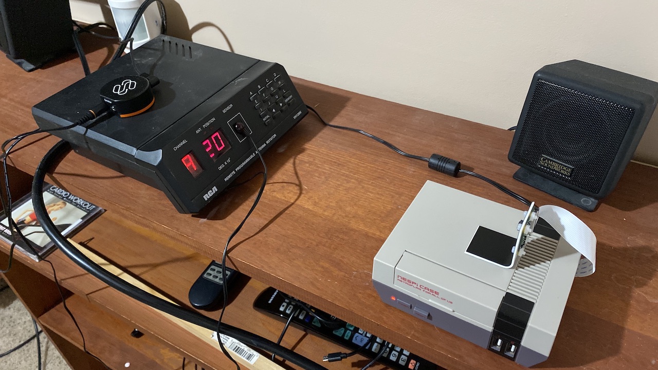

Received the Sewell Direct BlastIR Wireless Pro IR Repeater, Remote Control Extender Kit (IR Emitter and Receiver) and it worked right out of the box. Now onto the next phase, needing some way of knowing what direction the antenna is pointing. The VH126N has programmable set points but of course I would rather have the freedom of pointing to any direction when the notion strikes. Suppose I could setup a webcam to view the rotor control. Found a guy on YouTube who built an interesting setup but that also seems extreme however cool. https://youtu.be/OL32_ex3kCU

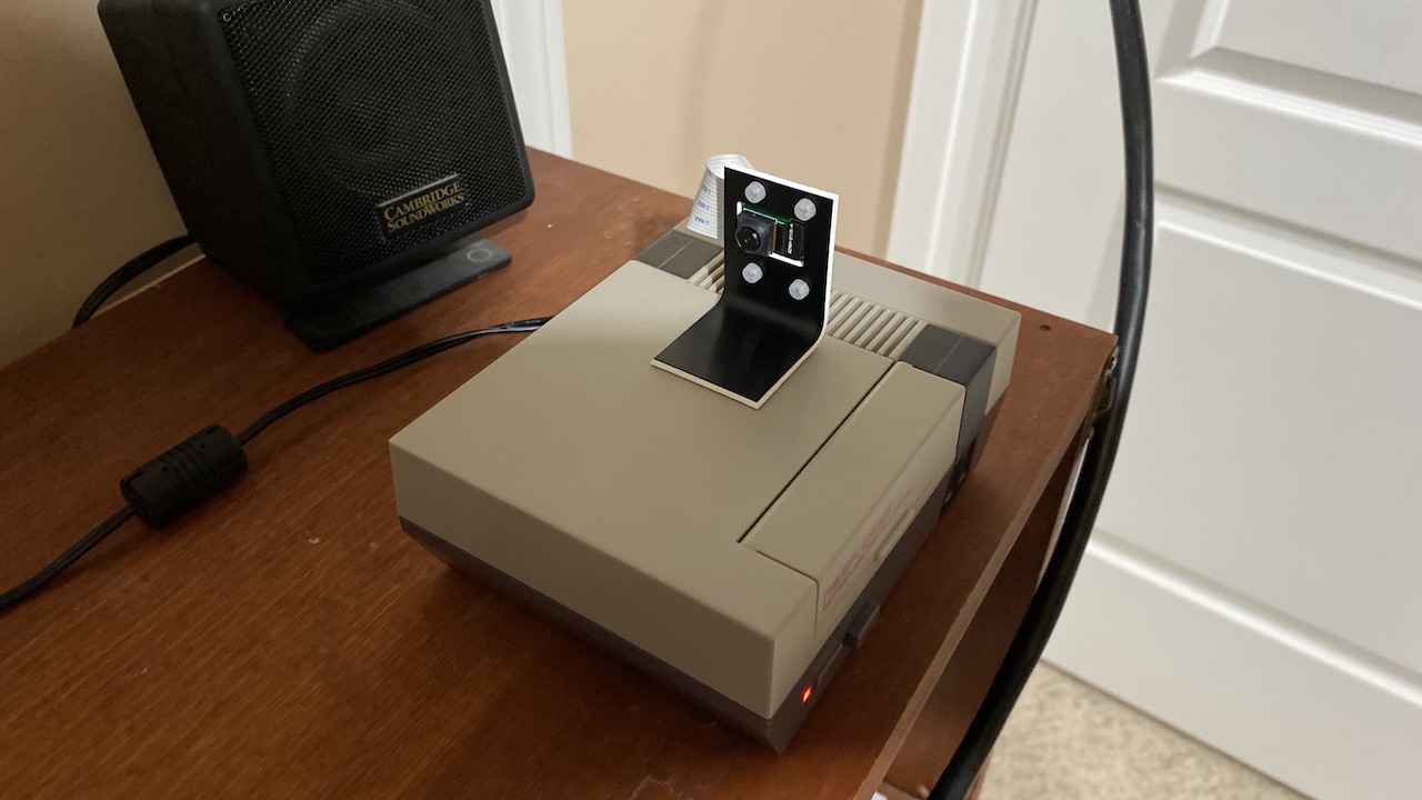

Modified an existing NESPi Case to provide camera cable access. Case also provides handy mounting surface for homemade Pi camera bracket and turned out to be ideal height to view antenna rotor control.

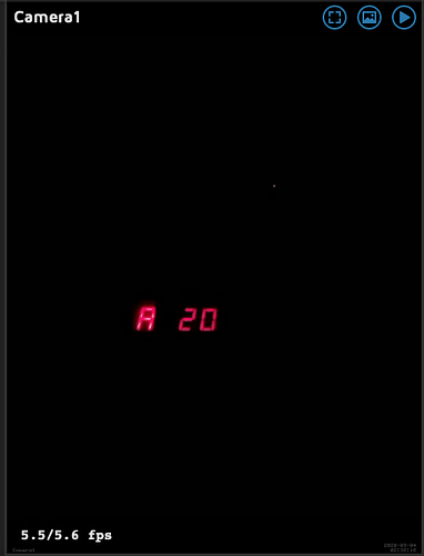

Configured Pi model 3B+ with motionEyeOS. Open a browser to the Pi IP address which provides camera view.
Sewell Direct BlastIR Wireless Pro IR Repeater, Remote Control Extender Kit (IR Emitter and Receiver) provides link from upstairs to downstairs location where antenna rotor is.
