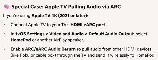

AI also suggested the pricing scheme shown in the screenshots below. Considering the size of the tv room and my seating distance from the tv, I don’t think I can justify paying anymore than $200 CAD. If the AI suggested prices are unrealistic, I’m not going to buy one.
If your TV has ARC, this suggests that you can configure the Apple TV to pull the cable box/Roku audio and play it on the HomePod too.
Thank you, that’s very interesting. I confirmed it through the Apple KB-Use HDMI ARC or eARC with your Apple TV 4K - Apple Support (CA).
My AppleTV and Roku are on separate wifi networks. Is that going to be an issue?
Don’t think so. HDMI ARC is over the cables, no WiFi needed, so as long as the Apple TV is on the ARC connector and it can see the HomePod to AirPlay to might work.

No, because both are connected with HDMI to the TV. The Apple TV has to be connected to the HDMI port marked with ARC (or designated with ARC in the settings/manual). Then audio output will be sent to the Apple TV, when the Apple TV is turned on.
It worked! Thank you everyone!
